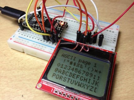

I'm just getting my first teensy 3.0 up and running and while I'm well versed in arduino, im self taught and prob lacking some of the skills I need to diagnose the issues im bumping into moving to the arm libraries.
I'm trying to get the u8glib lcd library up and running on the teensy and I've bumped into this error while trying to compile the basic test example included with the library
U8glib/utility/u8g_delay.c.o: In function `u8g_MicroDelay':
/Users/MEGA/R&D/Arduino/libraries/U8glib/utility/u8g_delay.c:151: undefined reference to `delayMicroseconds'
collect2: error: ld returned 1 exit status
as I understood it there is a delayMicroseconds function which is compatible with teensy 3.0 already, so I wonder if this is an issue with the library re-defining that function or if the two functions clash. Additionally I guess the question is how do I go about tweaking the library to fix said problem. Below is the code in the offending u8g_delay.c file.

My first impression is this looks like they're using delayMicroseconds() without including the Arduino.h header which defines it. That's called an implicit function declaration, and it's pretty bad coding form. If you enable verbose message from File > Preferences, you'll probably see a warning about implicit definition of delayMicroseconds.
Try adding #include "Arduino.h", like this:
/*== Arduino Delay ==*/
#if defined(USE_ARDUINO_DELAY)
#include "Arduino.h"                      //  <--- add this line
void u8g_Delay(uint16_t val)
	delay(val);
void u8g_MicroDelay(void)
	delayMicroseconds(1);
void u8g_10MicroDelay(void)
	delayMicroseconds(10);
If that makes it work, please contact the library author to see if they'll update their code.
The reason this works on regular Arduino is because their delayMicroseconds is implemented as an ordinary function that happens to match the implicit declaration (the assumption the compiler must make, because it wasn't properly defined).
For Teensy, I implemented delayMicroseconds() as in inline function with assembly language optimization. The result is much more accurate delays, even for 1 microsecond, and usually smaller code size (for a variety of complex reasons I won't go into here).
At least that's my first guess, from the code you posted. If that doesn't work, please post a link to where I can download the entire library and I'll try to take a closer look.
You nailed it Paul, made the small change you suggested and the library compiled fine and worked once I set my pins. I'll shoot an email to the u8glib library owner to see if they'll make an official change.
