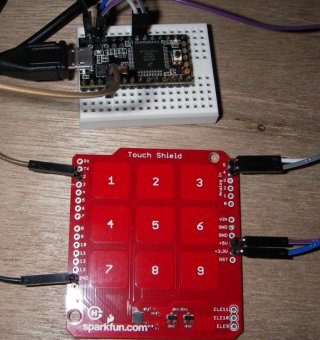

I'm trying to make a capacitive keypad using teensy 3.0 and a Sparkfun touch shield board. Since it's I2C based, I've only wired its SDA (A4), SCL (A5), 3.3V and GND to the appropriate teensy pins (SDA>18, SCL>19) as shown in the photo below.

First, connect Teensy 3.0's 3.3V power to both 3.3V and 5.0V on that shield. I know it says 5V, but it's only connected to the pullup resistors. You need those to have 3.3V for the I2C communication to work. (It's a very good thing you posted the photo with at least a small part of the wires shown)

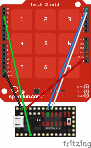

I've been to the Sparkfun quickstart guide here and done all the required wiring to the Teensy (see photo below)
SDA and SCL wired => OK
GND to Teensy AGND => OK
Both 3.3V and 5V to Teensy 3.3V => OK
IRQ pin (D2) to Teensy D2 pin => OK

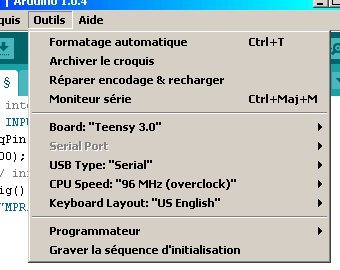

There's also a very weird thing.
My IDE settings are:
- Board: "Teensy 3.0"
- Serial port: COM3 checked
- USB type: "Serial"
- CPU Speed: "96Mhz (overclock)"
- Keyboard layout: "US English"
Now, if I add a Serial.println ("Debug test") in the loop() function to test display on COM3, then "Serial port" in the Tools menu becomes grayed... Why?
It would be hard to test anything if even the COM3 console won't display correctly :(

But then, the Serial port menu became disabled (grey) and if I choose to open the serial console, the Arduino IDE would refuse and say "Serial COM3 not found. Did you select it in the Tools menu?"
Of course I couldn't choose it, since it's disabled.
Finally, I just set a delay(6000); in the setup() after the Serial.begin() and it displayed the MPR121 init message well. Also, about the disabled Serial menu, all I had to do was upload the program twice by pushing the Teensy button twice and it worked fine.

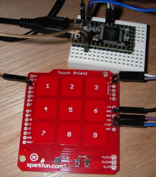

But now, the main probleme is that it doesn't detect any finger touch.. Maybe I should check my wires and jumpers again.
Yeeepeeekay! Well, I was such a dumb. Actually I was looking at my soldering, and I noticed that only the significant pins had a track on the PCB. And the GND pin I soldered the header to had nothing. So I decided to use another GND pin that had apparent track on the PCB. And voila! That would teach me to look more closely.
The Spakfun board has only 1 "working" GND out of 3. Anyway, it's working like a charm now.
Once again, thanks a lot for your patience and valuable help/advices Paul. Much appreciated :)
Could you post the final confirmed-good code and a photo of how it's hooked up? And post a comment on Sparkfun's page linking to this writeup? Hopefully if anyone else tries the same thing, they'll find your comment and it might help?
Wise indeed. Here are the correct pins to solder. As for the code, I got it from their quickstart download site, and didn't modify anything.
