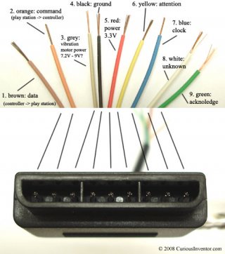

You need the female part of a ps2 controller. very cheap on ebay.
PS2 Controller Adapter
crack the shell open to get to the pins.
*Keep in mind that this pinout is opposite, because it is a picture of the male end.
And you don't have to use the pin 9 acknowledge...just
+3.3, Com, Clock, Command, Data, and Attention is all you "need".

I also found the "CuriousInventor" blog which explains in great detail the protocol.
The wiring is not straightforward, I had to used 120 Ohms resistors for each pin (as explained by Paul in another thread), and the data line needs a pull-up of maximum 3.3K Ohms. Else the data is not accurate and very noisy.
