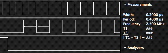

I'd like to interface with an older piece of computer hardware that is comunicating via a serial protocol with a bit width of .2us. Is either the Teensy 2 or Teensy 3 capable of this?
Here is a sample of the type of signal I'd like to emulate/produce (the bottom row, not the clock on top).
Here is my attempt on a Teensy 2.0

As you can see from the screen capture the timing isn't very accurate.
It should be: .6us hi, .6us lo, .4us hi, .8us lo, .2us hi, 2.4us lo, .2us hi, 1.4us lo, .2us hi, .6us lo, .6us hi
instead, I'm getting: .76us hi, .74us lo, .58us hi, .92us lo, .4us hi, 2.54us lo, .38us hi, 1.74us lo, .4us hi, .72us lo, .78us hi
Is there a way to improve the accuracy?

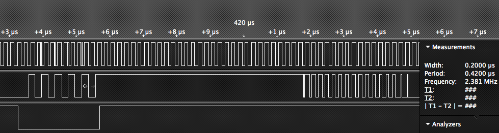

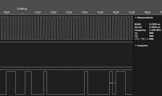

Thank you for you help. Using SPI in slave is looking really promising. I'm setting it up in slave mode feeding in the 5Mhz clock and then faking the SS with another port. The timing is very close now. Below is a simple test program that I wrote just to see how accurate I could get the bit width. It is just feeding 0xAA (1010 1010). Something is wrong though I see very clear .2us bits when SS is low but then it trails off high for a while before a bunch of garbage? Other times I see 1010 1010 10 six rises.
Here is the capture from my LA.

I just looked at the datasheet, and it looks like 5 MHz might be too fast. It says this on page 178:
In SPI Slave mode, the control logic will sample the incoming signal of the SCK pin. To ensure
correct sampling of the clock signal, the frequency of the SPI clock should never exceed fosc/4.
I also looked for the same info for Teensy 3.0. I didn't find it in the main reference manual, but the electrical specs it says the CPI clock cycle time minimum is "4 x Tbus" on page 47 in table 33. When Teensy 3.0 is at 96 or 48 MHz, the bus clock is 48 MHz, so that would seem to say Teensy 3.0 can handle up to 12 MHz in SPI slave mode. There's also a 4 deep FIFO on Teensy 3.0 and of course the CPU is much faster, so it should be a little easier to keep it fed with data to transmit as those clock pulses come in.

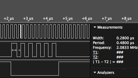

FYI, anyone else that is trying to get this level of precision out of an AVR. I was finally able to get it using SPI with the AVR overclocked to 25mhz (20mhz wasn't quite enough).
I used a Atmega328p with a 25Mhz external crystal.
