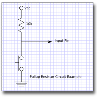

I am using Teensy++ 2.0. I have tested the external interrupt with the following code:
const int ledPin = 6;
const int wakeupPin = 2;
volatile int ledState = LOW;
void wakeUp()
  Serial.println("in wakeUp()");
  Serial.println("Turn on");
  digitalWrite(ledPin, HIGH);
  delay(5000);
  Serial.println("Turn off");
  digitalWrite(ledPin, LOW);
volatile int ledVal;
  Serial.begin(38400);
  pinMode(ledPin, OUTPUT);
  pinMode(wakeupPin, INPUT);
  attachInterrupt(wakeupPin, wakeUp, FALLING); //LOW,RISING, FALLING,CHANGE
  ledVal=0;
  digitalWrite(ledPin, ledVal);
  Serial.println("done init");
The external interrupt is set up with a pull up resistor, and I am detecting the falling signal. INPUT in the diagram is connected to INT2 (D2) on Teensy++ 2.0 .
