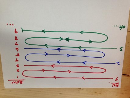

Hi all,
I'm using the OctoWS2811 library to send video to an LED panel (image here). I have my settings set as instructed in both the Arduino and Processing code. I have three issues, however:
1. The image is squished horizontally.
2. The image is not centered and some of it does not appear at all (see image).
3. I'm only getting 3 rows of LEDs for each pin instead of 4.
My LED matrix is made up of NeoPixels wired in a zigzag pattern (alternating direction of LEDs) starting in the top-left and ending at the bottom-left. There are 24 rows of 25 LEDs. Put another way, there are 25 LEDs horizontally per row, and 24 rows vertically.
My video file is 480 x 480.
Any suggestions of how to approach this? Code below:

One addition - the wiring.
I have a pin connection every 4 rows, for a total of 6 pins used. That's 100 leds per strip (4 rows of 25).
are you sure that these numbers are correct, as do not match your description of WIDTH and HEIGHT of there being 24 rows for Height?
#define LED_WIDTH      25   // number of LEDs horizontally
#define LED_HEIGHT     32   // number of LEDs vertically (must be multiple of 8)
#define LED_LAYOUT     0    // 0 = even rows left->right, 1 = even rows right->left
later, they are used for:
const int ledsPerStrip = LED_WIDTH * LED_HEIGHT / 8;
which would throw out some issues in that the programme thinks you are sending to more leds than you are using? I haven't used the video sketch for a while, though...
i think that you have to use all eight pins for the videoDisplay from processing to ensure you write out to all leds properly (but i might be wrong), this may be part of the issue for the bottom of your image missing.
Problem solved - it's all in the numbers
I was able to get it working and in so doing realized my fault - that the wiring and number of pins are affected by one another.
In my case, I had 24 rows and used all 8 pins in the end. That meant each pin was responsible for 3 rows. That meant I had to re-wire my matrix so that each set of 3 rows was independent. See image.
I could have used 6 pins and saved myself the re-wiring but I wanted all 8 pins working together to make everything faster.
