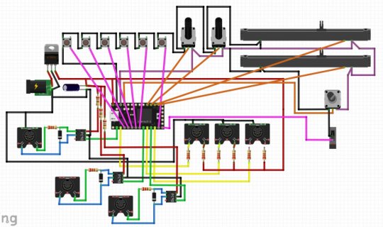

Ok, This has taken me all day to draw! Well, not to draw, but to find a program to use and figure out how to use it!
I have used the analogue ins for the buttons but I believe these could be bumped to the digital side? Its just the Pots and Faders that need to be on the Analogue side?
And as for the rest of the circuit - will it work?!
I am not circuit savvy but have looked at the midi specification to see how to do a MIDI-Out/Thru circuit and a MIDI In circuit... Mine differs a little because I want the Teensy to absorb all the data from the In, merge any potential data from the USB or buttons/knobs/faders and Output that to the Outputs...
Am I doing this right? Is this making sense? Or am I totally lost!

I have used a sharp PC900V for an Optocoupler - as recommended by the MIDI specifications, and put a power regulator on the input for safety.
The MIDI guidelines also recommend adding some ferrite chokes on the pins to the MIDI socket- I just didnt draw them in.
And I don't know for sure if I got the Diode or the Capacitor around the right way. I also started to get confused which pin the midi should be coming out of to go to the PC900... Brain melting. Time for bed!

Yes you can do this. you are totally on the right track
I didn't know that midi called for a ferrite choke!! I have successfully used this circuit (https://www.pjrc.com/teensy/td_libs_MIDI.html) (no choke). Midi thru is pretty easy and midi out hardware is really easy ... I'm not sure about running 2 midi out ports off one serial line, but seems OK (I've never done it myself) ...software merge is easy ...
As to sliders and buttons, I use 13 buttons and one motorised fader myself, outputing usb midi .... adding in your software merge is not going to be a problem ... I can give you the code.
One thing I would query is sync ... while you may be sending midi messages "at the same time", don't you need a MTC / MMC- type master to stop drift? Just starting them together is not really good enough is it??? I've not investigated that in the teensy context (cause I've never synced two sequencers ...) .... what do you need to send to keep sync / update transport speed, midi protocol wise? That could be 'tricky'???

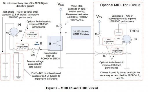

Cool, I designed the circuit using the Teensy MIDI reference page and some diagrams (below) I found in a Document here: http://www.midi.org/techspecs/ca33.pdf
You can include ferrite beads to "improve EMI/EMC performance".

I think the buttons need to be on the digital pins instead of the analogue pins but thats no biggie.
Maybe I have the MIDI lines round the wrong way on the connectors - I plan on using a different TX for each MIDI output - just cause I can really. As for Sync... I don't know anything about MIDI Sync! I assume if I tell a MIDI command to leave the Teensy on TX1,2 and 3 it will happen simultaneously on each output... Am I wrong?

Yes buttons are on digital pins (there are lots) ... faders and pots are on analog pins ...
You are right that if you send on TX 1 2 and 3 'at the same time' the midi messages will be spat out at pretty much the same time .... I was thinking you just use tx 1 but with two midi interfaces hooked up to in parallel, so midi would be 'simultaneous'

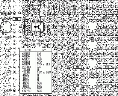

01-08-2016, 02:49 AM
In this example, the tx is split, then individually amplified? and then the 220 resister before each output...
6035
Other circuits I have seen use an IC to make the split... I think the Teensy should be able to handle doing individual serial outputs in sync for each "thru" - I will try it first, I think it is the simplest way forward?!

01-08-2016, 03:19 AM
.....BUT Oh shit, you gonna make me think about ohms law??? I think just whack another DIN on off the back of the other one ...would make current draw an issue I suppose, but voltage and resistance should be in spec ... must be a diagram for that somewhere ...
Anyway .... happy to help with the code ...just give us a bit of a thinking time ... Note that there are code wrappers under 'advanced' for posting code .. makes it easier to read
EDIT ... I see you are looking at schematics ... because its a software split fundamentally usig a teensy I'm not sure about the diagram .... putting the same signal out of two separate ports vs analog splitting of one port is probably neither here nor there ...interesting though (someone will know the answer ...)

Back to sync ... lets say you start the two transports at the same time (on different machines). You cut from one to the other after 5 minutes, I'm pretty sure that you are only lucky if they are on the same beat .....unless they are synced.
adrian
01-10-2016, 07:20 AM
So I tested the MMC code properly.. found a bug and fixed it ... now it works good ....
I updated the code post above
Mode select between MMC sysex and Midi notes (or CC evenutally) works fine, and channel select using a rotary works fine, but the lack of feedback makes it difficult to know 'what channel you are on' ... and it is easily bumped .... the rotary I have cost 4 dollars and the detents are not 'accurate' .... I could serial monitor the channel variable, but other than that I would have had no idea what channel. The slider works, spitting out 10 bit midi ... I remembered why capacitive touch is so good on faders.... when you are not touching it you don't need to read values!! great.
All this works over usb ...the next thing is to do the midi serial interfaces ... Like I said I have the hardware somewhere from another project ...but I have to work out coding for multiple serial ports (could just dispense with the midi library and 'do raw'!! whatever that may mean) ...and the mirroring thru needs to be sorted too ... there is a mirror thru function in the Midi library, just a matter of getting into it.
So ...all the easy bits are done ... on to a 2 x 2 interface with which to merge etc split etc.
I was thinking usb in from host, controller stuff, and 2 teensy serial in, all merged to the 2 teensy serial outs...
For usb out to host, I guess there is no point in mirroring back the usb in from host, so ..... controller stuff and two teensy serial ins, all merged to the usb out to host.
I found a weird hardware fault with my controller ... BOOO (I'm using pin 13 with the led on it as in input, plus register reads ... might not have got that quite right yet) .... so when I am fixing that (might be sh+t soldering??) I'll fakey up the serialMidi ins and outs,
I have a couple of spare optocouplers from an old project), and I'll get onto the midi interface code, now that the controller stuff is sorted.
I actually controlled my DAW using the MMC sysex messages.... the ffwd and rewind functions are weird, but they worked (just a strange implementation) ...punchin, play, pause stop etc ...neat.
Pictures (or it didn't happen):

I was hoping to finish off my 2 x 2 / usb midi interface over easter ...I've got to mount it / connect it, and test the software yet .. here is a picture of the perf board etc. Of course I also want to get into the studio to finish a song idea I started last week ... and work is just so busy at the moment... sheesh. AND there is a cool new teensy library 'Talkie' I want to play with... hmm
6846
I have exactly 2 x 270 ohm resistors!! You can have them if you like..... but they are like 2 cents or something from farnell / element 14 online... jay car can be a bit variable as to parts, but the wellington one is surprisingly good. Anyway, rock on, bro.

Cool man, I'll keep you posted, I may be able to catch up wednesday night... We'll see how it plays out.
I have 270 Ohm resistors, but the spec asks for 280... Am I being pedantic? Maybe a 270 is best used in parallel with a 10 ohm resistor also?
adrian
03-27-2016, 10:03 PM
Keep in touch, dude.
The schematic I use (https://www.pjrc.com/teensy/td_libs_MIDI.html) says 270Ohm. And 270 vs 280 just doesn't matter, in my view ... think about using 5% tolerance parts, and well,.... for a MIDI circuit I'm sure it makes no difference....
