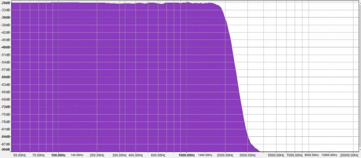

So CPU utilisation is very high.
It gets higher as the decimation factor increases. This is due to the cascaded filtering and decimation stages.
The FIR taps (antialiasing filter) are obtained with :
sampling frequency: 44100 Hz
fixed point precision: 16 bits
* 0 Hz - 10000 Hz
gain = 1
desired ripple = 1 dB
* 11025 Hz - 22050 Hz
gain = 0
desired attenuation = -80 dB

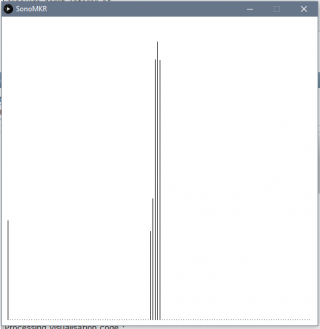

Arduinoi test code :
#include <analyze_fft256_decim.h>
AudioInputI2S            i2s1;
AudioAnalyzeFFT256Decim  fft256_decim;
AudioSynthWaveformSine   sine;
AudioConnection          patchCord1(sine, 0, fft256_decim, 0);
AudioControlSGTL5000     audioShield;    //xy=366,225
const int audioIn = AUDIO_INPUT_LINEIN;
//const int audioIn = AUDIO_INPUT_MIC;
const int decimFactor = 8; // choose decim factor, either 2, 4 ,8, 16 or 32
elapsedMillis lastDecim;
  Serial.println("setup");
  AudioMemory(20);
  fft256_decim.windowFunction(AudioWindowHanning256);
  fft256_decim.decimateSignal(decimFactor);
  fft256_decim.averageTogether(decimFactor * 5); // to get an FFT every (allmost) 1 second
  // Enable the audio shield and set the output volume.
  sine.frequency(int(10857/decimFactor)); // testing signal, allways the 63rd bin
  sine.amplitude(0.1);
  audioShield.enable();
  audioShield.inputSelect(audioIn);

Processing code (fft on a log scale) :
import processing.serial.*;
Serial myPort;  // Create object from Serial class
String  line;      // Data received from the serial port
int lf = 10;    // Linefeed in ASCII
float[] fft;
int xmax;
int ymax;
int deltaX;
int deltaY;
  xmax = 512;
  ymax = 500;
  deltaX = xmax / 128;
  int sizeX = xmax+20;
  int sizeY = ymax+20;
  size(532, 520);
  String portName = Serial.list()[1];
  myPort = new Serial(this, portName, 9600);
// Calculates the base-10 logarithm of a number
float log10 (float x) {
  return (log(x) / log(10));
void draw()
  if ( myPort.available() > 0) {  // If data is available,
    line = myPort.readStringUntil(lf);         // read it and store it in val
    println(line);
    if (line.charAt(0) != 'C')
      background(255);
      fft = float(split(line, ';'));
      for (int i = 0; i < fft.length; i = i+1)
        //line(10+deltaX*i, (ymax+10), 10+deltaX*i, (ymax+10)-(fft[i]*xmax/0.0005));
        line(10+deltaX*i, (ymax+10), 10+deltaX*i, -((ymax/48)*10*log10(fft[i])));
        //print(fft[i]);
