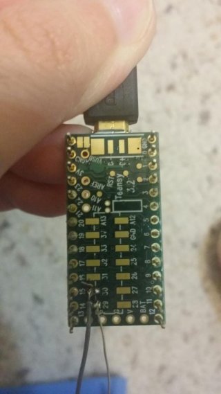

hello all,
For my project, I need to read data from 2 or more IMUs and although still I am not sure if it is possible, I want to read them with just one Teensy 3.2. I am using the code bellow to read one IMU and I use I2C. I think I should define the address for another IMU in functions "void Gyro_Init()" and "void Accel_Init()". But really don't know how (I am very new in programming Arduino and Teensy). Actually, I want to modify this code for reading two IMUs. Also, have no idea for two IMUs connections to Teensy (I can read one IMU and can connect it to Teensy).
Thank you so much.

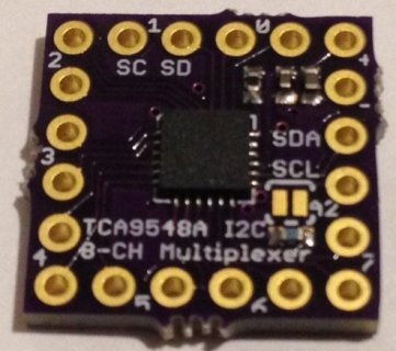

First question here, are you using two of the same IMU? And if so does the data sheet show anyway to change the device address? It certainly should be possible to have a Teensy talk to multiple addresses but doesn't help if the devices are locked to a single address.
Dear GremlinWrangler
Thank you for your reply. I am using two AltIMU-10 v4. you can see all the information and data sheet from here:
https://www.pololu.com/product/2470
I am sure from data sheet that two addresses for two IMUs are possible using SA0 pin. In data sheet it says:
"The slave address (SAD) associated to the LSM303D is 00111xxb, whereas the xx bits are modified by the SDO/SA0 pin in order to modify the device address. If the SDO/SA0 pin is connected to the voltage supply, the address is 0011101b, otherwise, if the SDO/SA0 pin is connected to ground, the address is 0011110b. This solution permits the connection and addressing of two different accelerometers to the same I2C lines."
So, what I have done is to solder the SA0 pin of one of the IMUs and it is connected to ground. The SA0 pin of the other IMU is free. I have connected both IMUs to the same I2C. but with that code, I am able to reed data from just one of them (the one with free SA0 pin) so I do not know how to modify the code to read the two. You know, I think it is a programming problem.
Thank you
Well you can at least have two IMUs, on the same bus which is a good start and if you couldn't was going to be a major problem.
Since you can, have a look in
https://github.com/pololu/lsm303-arduino/blob/master/LSM303.cpp
and
https://github.com/pololu/l3g-arduino/blob/master/L3G.cpp
for the line:
bool LSM303::init(deviceType device, sa0State sa0)

I suggest this add-on to do this:
https://www.tindie.com/products/onehorse/tca9548a-i2c-multiplexer/
I have one of these for this purpose but haven't gotten around to using it yet. But onehorse is a user on here, and his products are always top-notch, and the code to use it is always available.
Each of these gives you 8 i2c devices to control with the same address, and you can expand to 64 devices.
