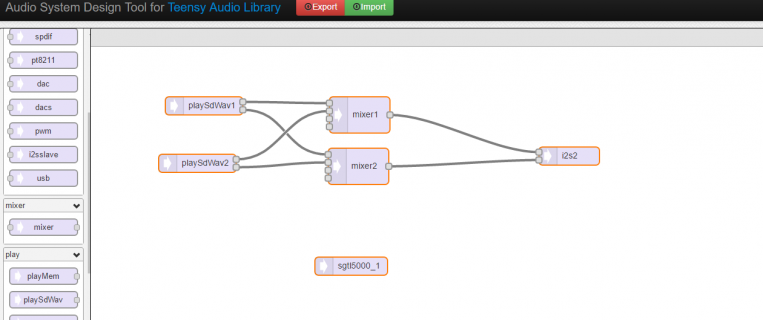

I just created another playSdWav object with mixer:
Then added some code to play this second object 1 second before the first one finishes playing.
Both playSdWav object are using the same file:

Twerk the delays to see if that does what you want.
if (!playSdWav1.isPlaying()&!playSdWav2.isPlaying())
& = bit-wise AND
&& = logical AND
I think you want the latter.
