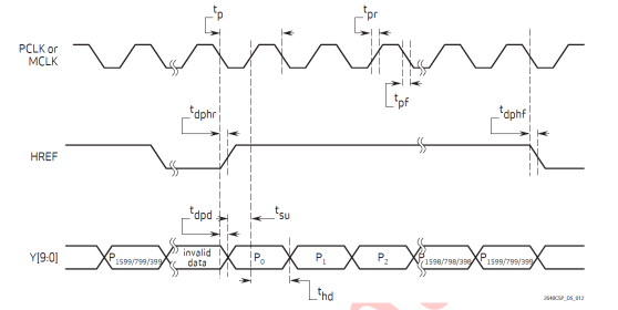

I am trying to read the data bus (pins d0 to d7) from an OV2640 camera using DMA on a Teensy 3.6. I am using Teensduino 1.37.
I currently have this implemented without DMA but am restricted to what speed I can run the pixel clock (PCLK) of the camera at.
The current the system is working at a PCLK of about 1MHz, but I would like to increase this by using DMA.
I have organised the data pins so that d0 to d7 are the first 8 pins on Port D of the teensy (GPIOD_PDIR).
Essentially the data is clock out and should be read on the rising edge of the PCLK.

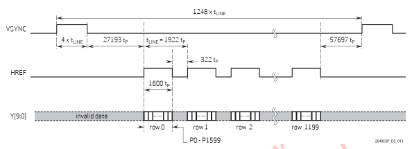

Here the pixel timing:
and the frame timing:
There is a lot of I2C code involved in setting up the camera.
In my case the camera is set to transfer jpg raw data so the data is not read out line by line but in just one single block.

I want to receive a single image and then stop.
How do I specify that I want to only read the first 8 pins of Port D?
How do I tell the DMA to transfer that byte into the memory buffer (rather than a larger word)?
How do I implement the VSYNC (frame start) and HREF (first line start) part into the DMA transfer?
