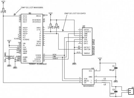

I'm trying to read the temperature off a MAX31855 Thermocouple amplifier and save the data to a text file on a microSD card. I have managed to do both things, one at a time. However, the problems arise when I try to do both in the same sketch.

So, now I want to combine these into the same sketch. The following sketch should read the temperature and print it in the serial output, then write a string to a text file on the SD card.
First, I run it without the SD card inserted. Initialization of the SD card fails as expected, and the temperature reading works fine.
Output:
Now, if I run it with the SD card present, it initializes fine and writes to the text file. However, the temperature reading is completely wrong! (It does however change when I touch the thermocouple with my fingers.)
I could do a dirty fix and just add some constant (+2049 looks about right) to the temperature reading to get the following output:
But that isn't very satisfying..
So it looks like the SD card SPI communication is interfering with the MAX31855 library in some way.
Does anyone have any idea what the cause might be? And any suggestions for troubleshooting or fixing this problem?
Here is some info (just ask if I forgot something essential):
- SD card and MAX31855 shares DI (MISO) and SCK
- SD card has chip select on PIN 2 (with pull-up resistor) and MAX31855 on PIN 14 (also with pull-up resistor)
- MAX31855 uses hardware SPI
- Arduino software version 1.8.10
- Teensyduino software version 1.48
Schematics:
Initializing SD card...initialization done.
Temperature is -2021.25
Writing to file...OK.
Temperature is -2021.50
Temperature is 27.50
Temperature is 27.75
