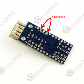

      And the hits keep coming! You certainly are a wonderful resource. Thank you for the latest schematic. I'll be away for the next two weeks on another adventure but will delve further into these mysteries when I get back. It has now become an...

      Hi Paul, Thanks for your comments and the links you have included. Have you succeeded with any of these clone hosts? I ask because there are so many complaints posted without success. The hosts I have now "look" like the original circuits@home...

      Has anyone succeeded in connecting a Chinese mini USB host to a Teensy or other board and had a program process USB input all the way to its intended output on the TX line? If so can you post a complete wiring diagram with pin functions? And the...
