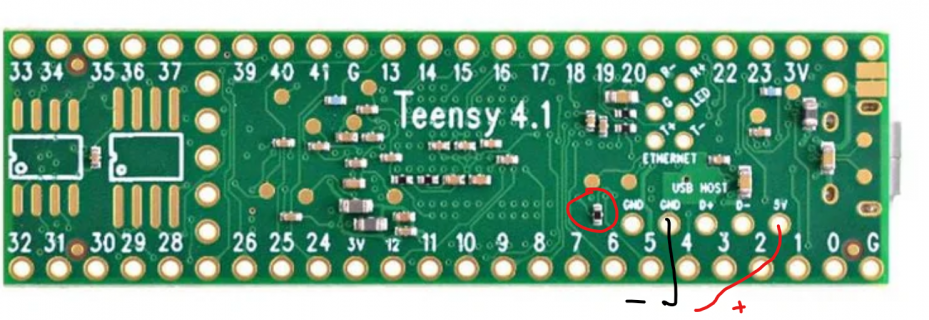

Figured it out after cracking out my big thick glasses, I stupidly seen that I had the tinest bit of solder bridging the component circled in read, gently removed it and boom! voltage!
Hi guys, just got setup with the teensy 4.1, my project involves using USB host. I have flash the below code and I a not getting any volatge betwwne 5v and GND, any help would me musch appricated as I'm at a loss.
Viewing the serial monitor I...
