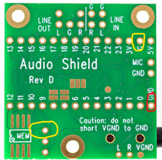

I already have a 100 Ω series resistor on the MCLK line. You can see it in the codec schematic that I posted in the previous chats.
When I tested my codec custom board with a Teensy, all the connections were made using jumper wires, and the...
Update: MCLK testing results
The RT1064 board and the codec board are two separate boards, connected with jumper wires. I tested the codec using MCLK from two different sources, with the same RT1064 I2C firmware.
Test 1: MCLK from the RT1064...

This is the code i am using in teensy with my custom board codec
and i am getting 0x0A correctlly

On the MCLK pin I am getting 1.6 V.
Now, as output, I am getting this:
