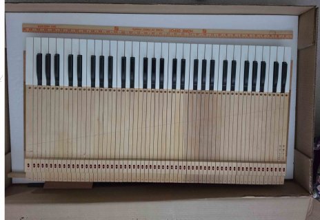

The keyboards are nice. I hope I do them justice with building the organ pedal board. I got keyboards, presets, bench adjustment mechanism and keyboard parts from OSI; Organ Supply Industries. I am attaching a picture now since I don't remember...
