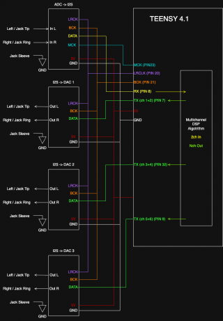

Ok thanks, this updated version seems about right I think then:
The DC power of my ADC and DAC PCBs needs explicitely to be 5V, can I use USB-C to provide power to the Teensy board and get the 5V DC power from one of the Teensy pin?

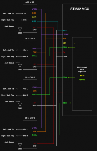

Schematic looks ok in principle.
Recommend a few edits:
Add pin numbers. Use design tool docs panel.
Check power supply voltage, probably not 5V
(most important part) Edit "STM32" to "Teensy"

I did this principle scheme to illustrate what I would like to do.
Would this kind of wiring work by using:
- "i2s" block as for stereo input
- "i2s_hex" block for 6 channel output
and insert my DSP code in the middle?
Thank you so much @PaulStoffregen for all those detailed advices.
I will definitely have a look to all the resources you mentioned and see if I can figure out how to make this work.
For TDM, I found this Analog Devices chip that could be perfect...
The Teensy 4.x boards are ideal for this. Start at this page https://www.pjrc.com/teensy/td_libs_Audio.html, look at the Design Tool which is linked from it (and be sure to look at the Info pane at the right, which tells you what pins to use)...
