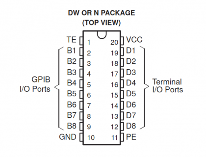

Its 3.2V when Teensy is driving it high which should be adequate. Further testing shows that the SN75160 is working fine. When TE is low then the external D pin states change in line with the state change of the Teensy pins. I also tried the...

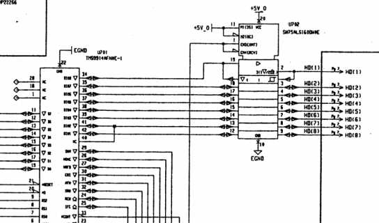

Thank you. The aim is to have the Teensy isolated from direct connection to the GPIB bus. The GPIB I/O side is currently connected directly to the GPIB bus (with the instrument at the other end) and the Teensy is on the terminal side. I take your...
Can anyone confirm whether it is possible to drive SN7516x buffer ICs using a Teensy?
I seem to be having difficulty driving the TE (Transmit Enable) pin from a Teensy GPIO - tried pins 2 and 3. I see the GPIO going up and down for high and low...
