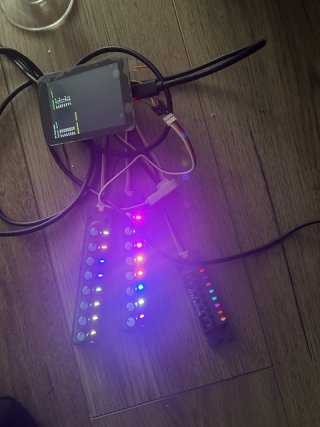

I kept hitting issues with hardware so decided to split out a midi controller using the waveshare esp32 s3.

Been a hard week. Last weekend I ended up messing up my latest teensy board so it no longer gets the encoder pulses from my microdexed.
So after a few nights soldering and re soldering I took the decision to split the synth engine out. So now...

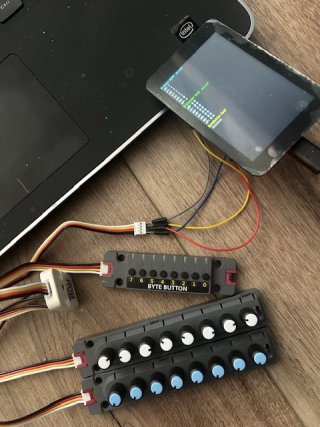

got a bit fed up with soldering and breaking things so I’ve went down the M5Stack for my prototype
Dare say I’ll be in the M5Stack library later this week.
Did you 3d print the case?

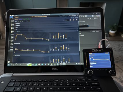

been working on the patch conversion and loading. Small side quest means my envelopes now have curves and can be updated whilst playing.
All this is supposed to be done on my own project once I get through this training project 🙈 but loving the...
I assume that's a limitation of your Jeannie 1 project - with my code you could always set all of attack, decay and release to near-linear.
However, you couldn't change the sustain level live; I've pushed up some changes to allow this, using...
