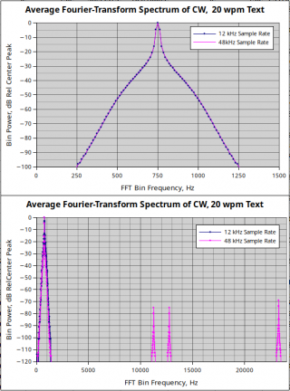

      Bob Larkin replied to the thread CW generator.
      The spectrum of the F32 CW Modulator was measured by sending the alphabet in 5 character words along with some numbers. This was adequately random to suppress periodic spikes when averaged over a number of FFT. Measurements were done at a...
      Hi All - just got back from weekend trip and got to the CW modulator. I re-fixed PR 31! Also I removed some unused variables and did the timing tests. At Sample rate = 12 ksps, the update uses 81 uSec which is less than 1% of the available...
      Hi All - I had distractions, but did finally get a CW Modulator that runs with sample rates near 12, 24, 48 and 96 ksps. It does not have the efficient interpolation that I was hoping for, but more importantly, it works. I put it up on the...
