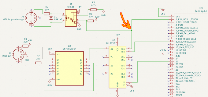

I'd like to be able to both have a HW MIDI thru and also at the same time read the input into Teensy 3.6 Can I just connect the optocoupler (U1) output to both Teensy RX1 and the output buffer (U3) like this?
The 74LS157 (or CD74HCT157E) switch...
This schematic works for me, although adding a 4.7k-10k resistor to ground from pin 7 (based on this suggestion) seems to improve the rise time of the output signal.

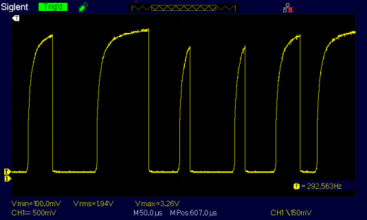

without the resistor:

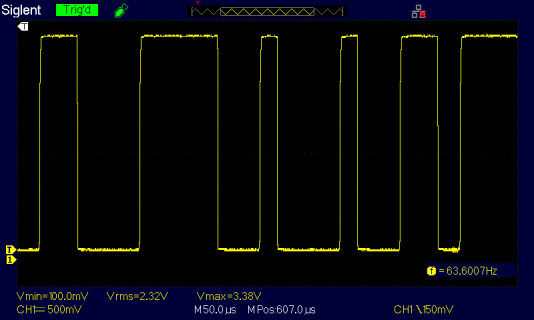

with the resistor:
