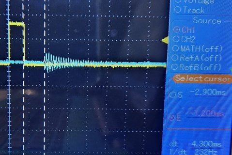

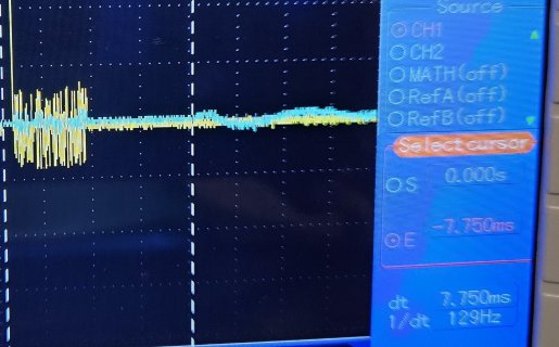

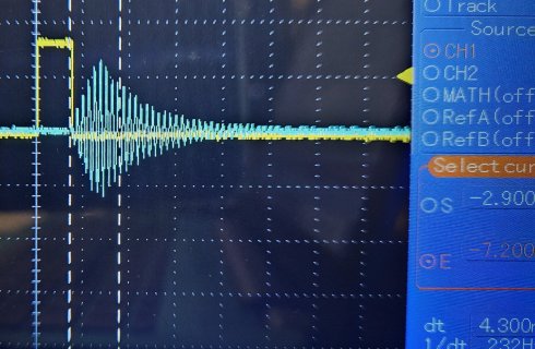

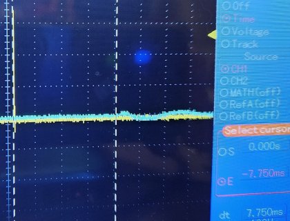

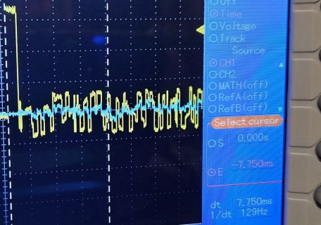

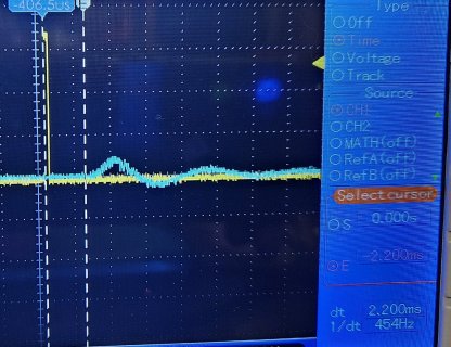

      Hi h4yn0nnym0u5e I've made further investigations and made the following changes to the code:- - Replaced the piezo trigger with a simple trigpushbutton.risingEdge() check on an input pin, triggered with a 3.3V input ('trig_pin') to eliminate...
