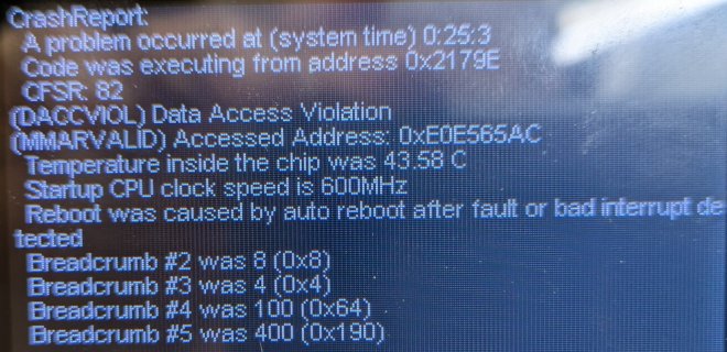

    clinker8 replied to the thread t4.1 detect reboot type.
    @defragster [arm/bin] $ ./arm-none-eabi-addr2line -e ~/Library/Caches/arduino/sketches/C798958FCBDCA6AB7A9C28AB1D2FD52A/teensy-electronic-lead-screw.ino.elf 0x2179E ??:? [arm/bin] $ This is not enlightening, is it? ??:? what kind of answer is...
    Well got another error during high speed operation. Fastest lathe speed, and fastest feed rate. The output is different than I've seen before. I know where the breadcrumbs are. (2,8) main loop after using an instance of elapsedMillis (3,4)...
    Grand experiment starting. Have littered my code with breadcrumbs. Entered using an #if defined(mycrumbs). Breadcrumb(n,x); #endif. On the one hand, I hope I capture something so I have a clue where to look, and on the other hand, I hope...

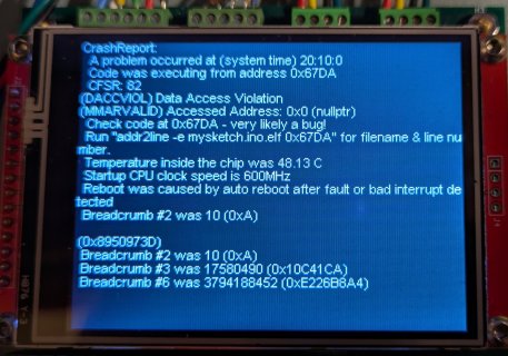

    try tft.print(c); instead of tft.drawFontChar(c);
  • C
    Turns out that the write method, calls this one: size_t ILI9341_t3n::write(uint8_t c) { return write(&c, 1); } You can probably get rid o warning like: tft.write((const uint8_t *)&c, 1);
  • C
    This write method generates a warning about an invalid conversion. It may work, but the tft.print(c) seems adequate for my purpose. Now there's only two line wraps, which is a lot more readable. I'm at 8 point font though! But it's readable...
  • C
    Thanks, that worked. Now it is readable.

    I must say the formatting of the serial console and the display are very different. How can I make the display similar to the console. It seems that CR and LF aren't allowed for the display? How can I handle that? I just get a run on sentence...
    I interspersed some bread crumbs all at level 2 with differing values in my loop code. So I have bread crumb (2,1) through (2,10) I'm trying to interpret the result. I forced an error in the main loop using elapsedMillis and then referencing a...

    I recently experienced a Teensy crash/reset while controlling a motor on a lathe. Quite often, there isn't even a console attached, just an ILI9341. Trying to install bread crumbs and whatnot in my code now. I want to both write to serial AND...
