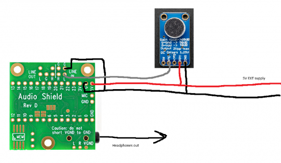

My apologies for not being more clear. I have the Teensy and Audio shield connected using stack-able headers. I am powering the Teensy4.1 through the 5V pin, which I assumed would drive the 3.3V output to power the Audio Shield. Is this...

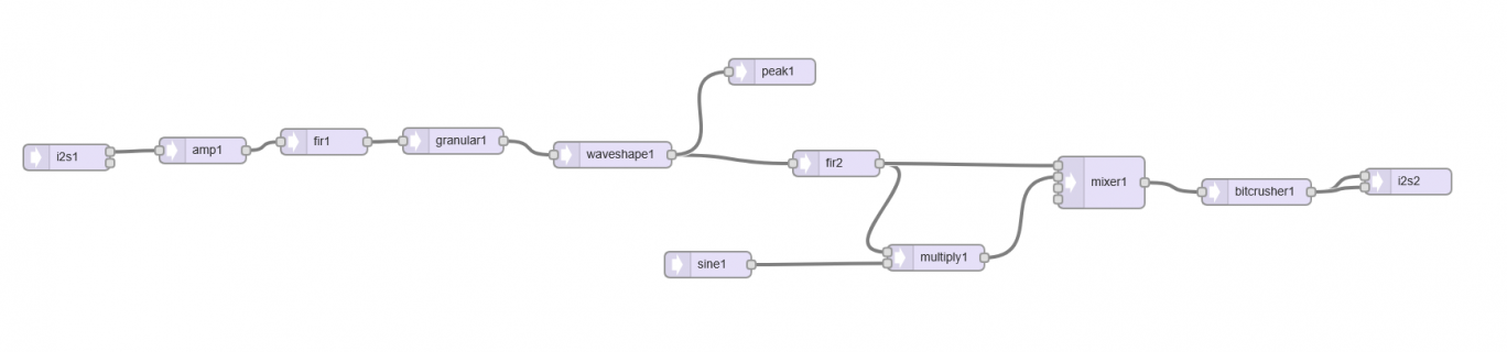

Hi all,
This is my first post and also first project coming back to tinkering after a while (still kind of a rookie at these things). To summarize what I am trying to do, I am looking to create a real-time voice changer using a Teensy 4.1 and...
