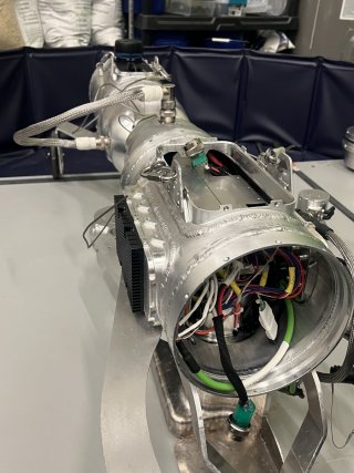

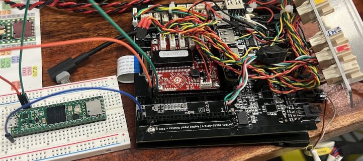

That is some serious looking hardware! I was dubious that you could be stressing the PTC that much as I have never heard of this PTC issue with Teensy before, but it looks like you are indeed sending Teensy where no Teensy has probably gone...
Sure. First, no, we are not using the SD at all. No card in the slot.
The robot where we run the teensy is FULL of heat-producing electronics and motors. The teensy itself is mounted on a PC board that is stuffed with other electronics and...

With the new board, I've now added 320 mA of external load on the 3.3, with the board drawing 162 ma with no external load, overclocked at 804 Mhz, and no problems wth the PTC.
Total USB load is 487 mA. PTC output is 4.6V so it's dropped some...

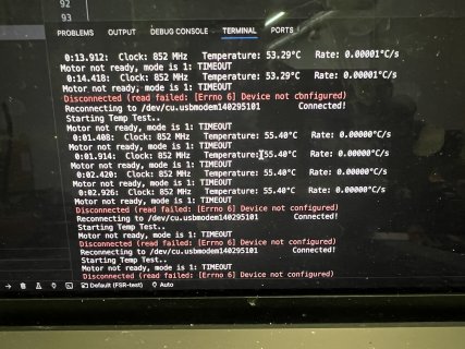

This morning, I pulled a brand-new Teensy 4.1 out of the box and have been testing it. So far, I've seen no PTC fuse issues on the new board. I've only run at 200 mA loads so far but was getting ready to add some external load to the 5V circuit...
I did a bit more testing yesterday on a Teensy 4.1 board with the PTC fuse removed. By overclocking the CPU I could force it to draw more current and produce more heat. On a board with the fuse removed, I could overclock all the way to the max...

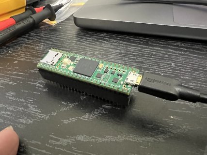

We just had to hunt this bug down for work, and I thought I would share what I found.
We have a Teensy 4.1 as a controller in our robot that recently started rebooting for no known reason.
It would not just reboot once, but keep repeating every...
The F1 PTC fuse I suspect, is this part: https://www.digikey.com/short/5t5fjzj3
