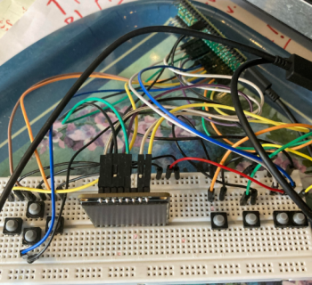

Update: So I discovered that I didn't have the 3v pin on the audio board connected to anything. If soldered to the teensy, it would go to this 3v pin on the teensy: (circled in picture)
So I directly connected it to that pin. The result was that...
So at this stage of my project I have everything on a breadboard connected with jumpers. All the buttons each have one of their terminals going to the ground rail which is connected to one of the teensy 4.1's ground pins, and the other terminal...
Update: I tried hooking it up to the teensy and got it to output a beeping tone, (using the tone() function) but extremely quiet- even with the volume potentiometer turned all the way up. My conclusion, playing sounds with this speaker can be...

A few months ago, I started on making a project that I wanted to have near-infinite replayability. This project has turned into a sort of roguelike dungeon crawler that has real-time combat and an inventory/items system. The hardware so far is...
