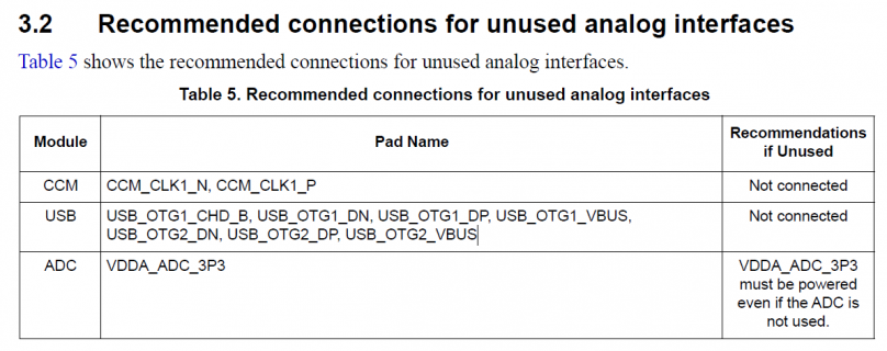

      Denis Bélières replied to the thread Problem in Teensy 4.1.
      Yes indeed, without 5V the internal USB drivers won't work. But the data sheet (not reference manual) says that the VBUS pins can be left not connected when not used. So the chip can be powered with 3V3 and other lower voltages derived from 3V3...
      But I do not want to have two power supplies ; one 5 V for teensy, and one 3V3 for peripherals which do not withstand 5 V... It is far simpler if my whole logic system is powered with only one supply ! I have yet an unregulated +18V from a...
