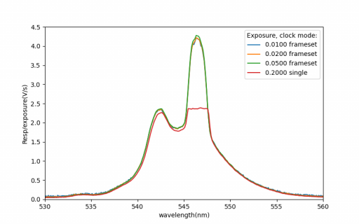

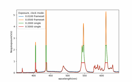

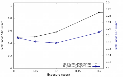

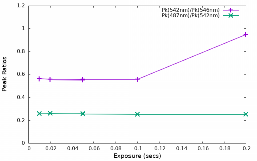

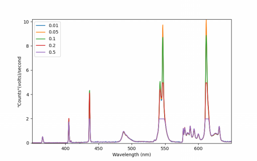

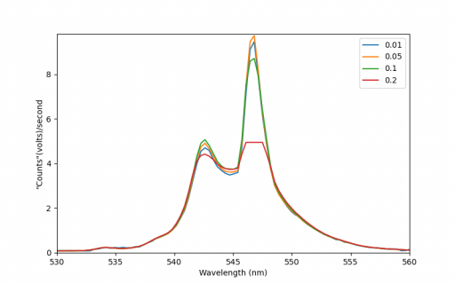

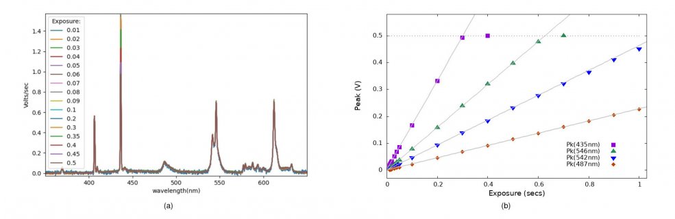

      DrM replied to the thread ADC tests for TCD1304DG.
      I just noticed my earlier post #21, and there are a coupled of things that probably need to some correction or clarification. The first is that two important issues in working with the TCD1304 and any CCD sensor, are the following: 1)...

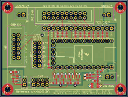

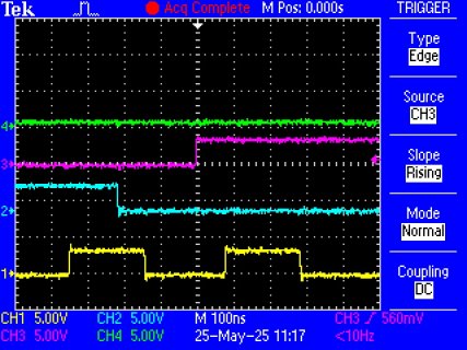

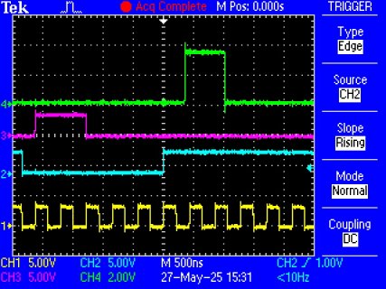

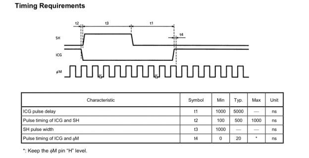

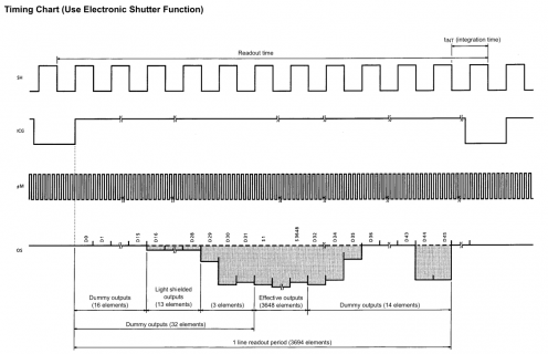

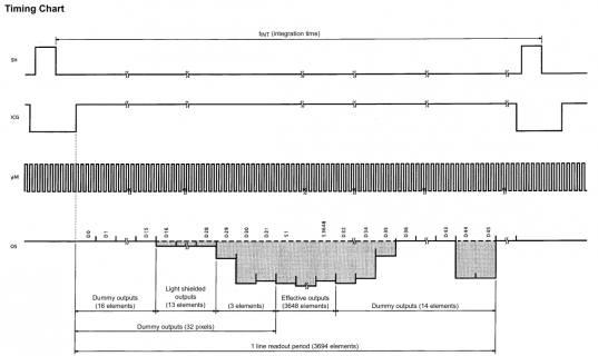

      Yes, it seems I keep missing the fine print. But I am not clear about how it would work. I think that is why I miss the fine print. Can we start the Quad Timer from the FlexPWM? And vice versa, can we start the FlexPWM from the Quad Timer?
    • D

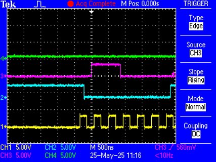

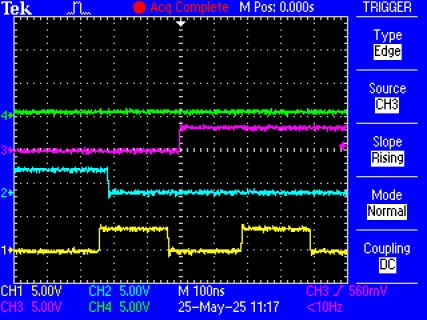

      It seems like the linear CCD would need a combination of the FlexPWM and Quad Time and I am not sure that it is possible. In the following I connect ΦΜ, ICG and SH, to pins 4,5,6, all on FlexPWM2 submodules 0-2, all of that seems...

      Well.. the reason I asked, is that NXP's support engineer told me it can't be done, i.e. starting the SPI from the flexpwm without an ISR. We talked about this quite a bit and eventually I filed a support ticket to ask how to do it. That took...
    • D
      Wow, that would be fantastic. It is a really generic problem, just about every ADC and DAC that we might use needs this. I asked here and NXP and was told it is not possible. Can you please show an example using the flexpwm and SPI without...
    • D
      Could you please show an example how to cascade two FlexPWM without using an ISR? That would be sooo helpful. Thank you

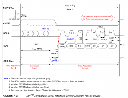

    • D
      Simple example, let's say we run the convert signal for an ADC from a FlexPWM submodule. How do you start the SPI 30 nsec after the trailing edge of each CNVST pulse? You can use an interrupt and setup the relative timing with other channel of...

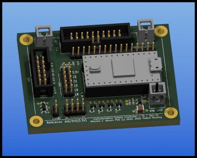

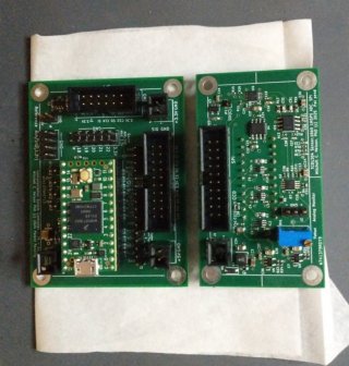

      Why am I doing with this Teensy, you might ask. The project is to make open designs for high end instrumentation available and affordable. The collaborators in the designs are late career instrumentation physicists. We have had downloads by...
    • D
      Sure, easy, The timing for the gates for a CCD, the timing for an ADC, similarly a time to digital converter for photon tagging, and simply counting pulses from a PMT. The problem for the first two is partially resolved with the flexpw, it...
