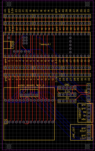

Will try that, never try to route myself

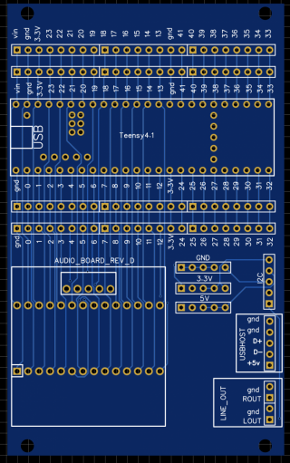

If i add spot and don't use resistor do i need to solder a jumper in place?

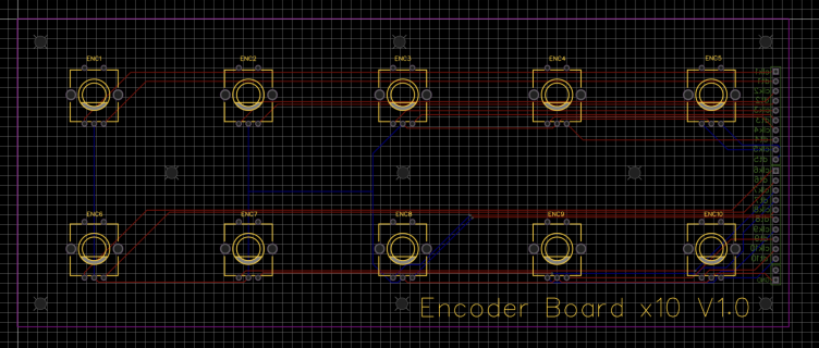

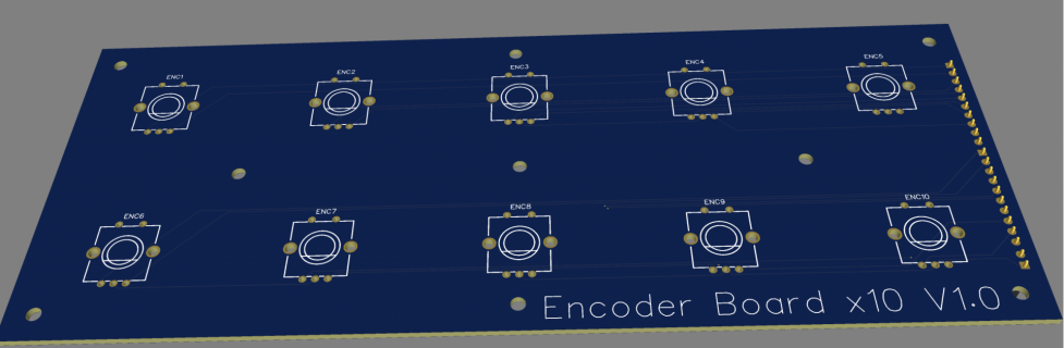

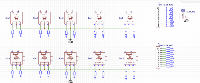

The encoder board is one project, but the breakoutboard is for many other ones, so for the monment will proceed with wires...

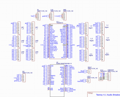

Newbie in PCB design here. I need some advice before asking JLCPCB to produce a little PCB for me. Working on some synth project with 4.1 and Rev D audio board and want to make my own PCB to prototype some stuff. Can someone tell me if it's...
