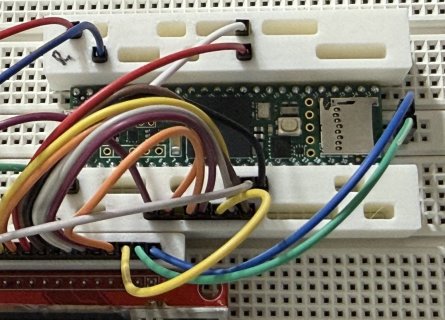

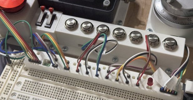

Still waiting on ICs and stuff. Meanwhile I got the mechanical parts in and 3d printed the inputs for the switches and stuff. That is giving me a sense of order on the breadboard 😊

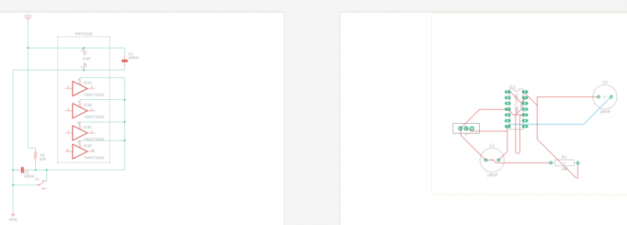

It took me most of the afternoon to get KiCad hooked up to github so that I could version control my project + "integrating" it with Mouser which is where I'm getting my parts (to ensure I get the right sockets, etc). Not sure which of the 2 was...

What I have done so far is to 3d print some helpers like this one

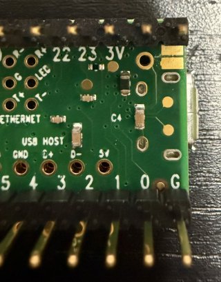

I'm certainly a criminal here and Paul will probably cringe, but I've never cut that trace and I have powered boards with both sources simultaneously due to my application.
(Normally powered via a 12 volt supply, but frequently powered via USB...
For wiring a semi-permanent breadboard setup, I recommend using the U-shaped jumpers like shown below that lay close to the board. The wire is heavier duty 22AWG and provides more solid connections.
While a little more trouble to initially...
Treat the schematic as the single point of truth and build up the breadboard circuit from it, perhaps crossing-off nets from a printed schematic as you go to avoid missing anything?
You can build up a wiring diagram the same way on squared paper...

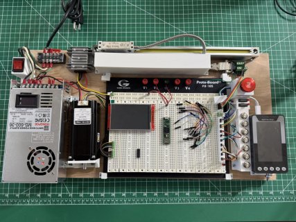

I just got stated with embedded and I suppose my starter project it is a bit big. It is a universal testing machine and uses over 30 of the Teensy pins plus there are other surrounding ICs and components plus a USB interface to a...

Hmmm... in the project that I'm working on, a universal testing machine, the stuff is simple, move this, measure that, record stuff, show some graphs and calculate some properties. Though there is a lot of UI and a fair number of inputs as in...

The ohmage is close to zero. I'll get that little tail out... need a pair of magnifying glasses, as soon as I get it out of the breadboard. Right now it is in a mess of wires :)
Thanks!!
It still works - powered by USB that is good.
Looking at the linked page it shows the right spot and seems it has been hit in the picture.
One note there is: "Use a DMM to verify there is no continuity between the pads."
Apparently there is...

I want to program the Teensy 4.1 while powering it from the breadboard.
Issue:
I cut what I thought was the VUSB trace, but I'm afraid that is not the case given that when not in the breadboard and powered via the USB...
