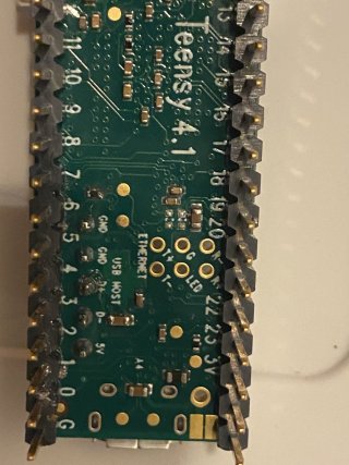

      ExNoise replied to the thread USBHost_t36 not reading.
      I also measured the resistances between the pins to see if there’s anything shorted, between the 2 ground pins there is effectively zero resistance but considering they’re both ground pins i guess they’re supposed to be wired together? The...
    • E
    • E
      Hi, my teensy 4.1 is not reading usb signals anymore, i (clumsily) soldered on the headers on the teensy board and it worked until today. I tried some example sketches for the USBHost library (mouse and inputfunctions) and yesterday the mouse...
