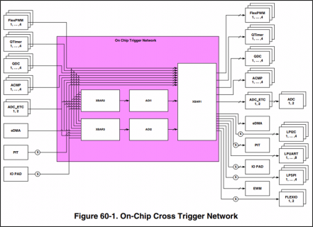

Is it possible to route an input signal through XBAR1 to an unused input of an unused module (e.g. a trigger or secondary input of a quadtimer) and then use that line as an input to XBAR2 or XBAR3 for the logic function? It'd be a bit of a waste...

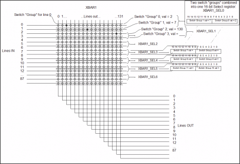

The following corrects what I got backwards in the post above. This clarifies that the XBAR MUX's are arranged in columns not rows.
Notes to Orient Uninitiated Users of the XBAR Module:
I find it helps to have a good mental model of what I’m...

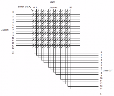

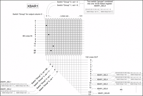

Dang! I believe jmarsh is correct! I was afraid I would get that wrong.
I should have noticed that there are 66 XBAR1_SELnn registers. With each one holding two connections, that covers the 132 output lines, not the 88 input lines.

Ok - I finally worked through this. Here are some notes I think some other newbie like myself might find useful. Same content also attached as .PDF...
I find it helps to have a good...

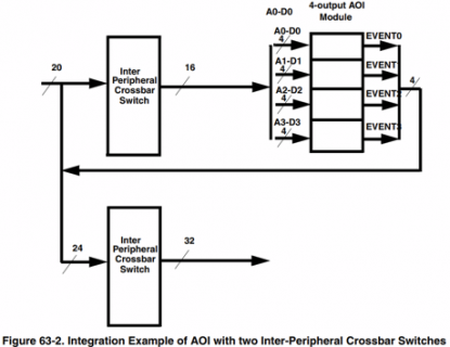

I forgot to mention that I want to keep my TMR3 module 1 & 2 outputs to continue to route to their normal output pins, while _also_ routing to the AOI block to get ANDed together and output as...
For the life of me I do not understand how to look up which 2-Byte number corresponds to a module's output or input (to use in the XBAR select reigster).
I want to route TMR3_Module2 and also TMR3_Module 1 to one of the AOI modules (to AND them...
