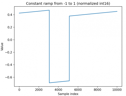

Here is the full code with the Serial.write not in the ISR:
#include <Arduino.h>
#include <imxrt.h>
#include <DMAChannel.h>
#define BUFFER_SIZE 8192
#define SEND_SIZE BUFFER_SIZE*4
void xbar_connect(unsigned int input, unsigned int output)...
Hello, I am attempting to read parallel data on GPIO1 using DMA as fast as possible, and wanted to know if there is a way to set the output buffer to somehow be the USB FIFO buffer. My goal is to get continuous data from the GPIO register as fast...
