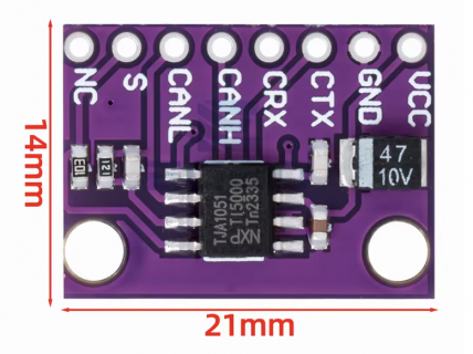

Im now using this one : 1051 TJA1051 TJA1042 High speed low power consumption and CAN transceiver module TJA1051T.
I have tested 3-4 different ones , and found this to be the one working best for me .
NB - just remember the module has and 120...
