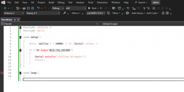

      I sabotaged SD.cpp and it didn't notice, so yes, the path is not pointing to the right place.

      OK, so I replaced my #include <SD.h> with #include <C:\Users\hkems\AppData\Local\arduino15\packages\teensy\hardware\avr\1.59.0\libraries\SD\src\SD.h> It recognised BUILTIN_SDCARD (it read the header) but still doesn't find the code...

      OK, the same code failed in VS2022. You can see that it didn't recognise BUILTIN_SDCARD. I had trouble setting up the VS2022 for teensy and maybe it's come back to bite me.

      OK, the code above compiled and linked to Teensy 4.1 and loaded to the board, in the Arduino IDE. As I expected! With regard to posting all the code, I hoped that I was just being a wee bit Pascal and that the answer was immediately apparent to...

      Apologies. This probably comes from me mostly programming in Free Pascal ... I keep on getting the following message when compiling my C code in Visual Studio 2022: ld.exe: CIS030925.cpp.o: in function setup CIS030925.ino:61: undefined...
