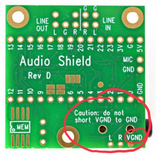

  • h4yn0nnym0u5e
    Do you mean the headphone jack? If so, note this warning: The “ground” on the headphone jack is NOT the same as Teensy ground, and shorting it to ground usually results in no or poor output. The shield silkscreen is pretty much the only place...

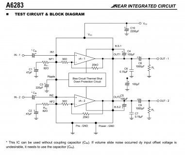

  • h4yn0nnym0u5e
    If that’s how you connected the amplifier, you probably need to do more. Here’s the test circuit from a datasheet: the datasheet I found is at http://www.utc-ic.com/uploadfile/2012/0316/20120316040633653.pdf; you should check it’s close enough...
