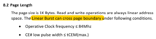

Also, looking at your image of the parts you've fitted, the PSRAM part number is unreadable, so much so that it appears to have been deliberately removed. I...
For the 8MB parts, the datasheet says:
For the ISSI 16MB parts, we're told:
So the stress test needs to ensure that there are plenty of burst reads or writes which could cross the 1024-byte page boundaries. The original PSRAM test doesn't...
I would say not, then. Until there's wider availability of the 16MB parts so @jmarsh can test his PR#708, the prefetch optimisation will have to wait for another Teensyduino cycle.
Yes indeed. My PR on your PR shows the register settings needed to keep the ISSI part happy, but they’re macro-controlled rather than based on detecting the part at run-time, which would be the correct solution. I was aiming to let you make those...
