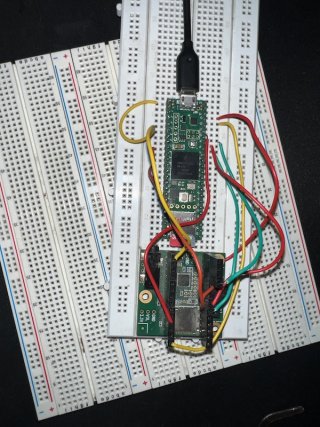

Hi Paul, I don't know if you understand wiring. the 3.3 is connected to pin 3.3 of the shield
thanks
I
Rev C audio shield (the Teensy 3.x one) on a Teensy 4.1. Pinouts don't line up so it's wired point to point:
shield 11 (MCLK) -> Teensy 23
shield 9 (BCLK) -> Teensy 21
shield 23 (LRCLK) -> Teensy 20
shield 22 (DIN) -> Teensy 7
shield 19...
