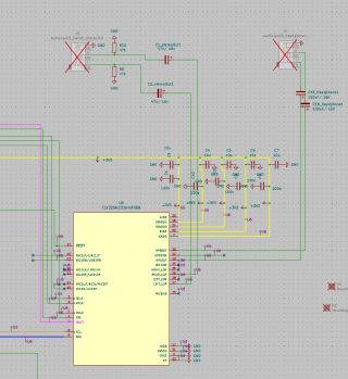

      I modified my pcb as you described and got the resistor working, also I finally got some sound out of it, but it's still far from ideal. It's hitting the correct frequency and a sine wave sounds good, but everything else, like square or sawtooth...

      Thanks a lot, both of you. That's all very helpful and gives me hope again. 🙂 It would have been a miracle if it had worked straight away, but I would love to make sure my second version is definitely working. :)) But yeah, it looks like the...

      Thanks a lot for this thread. I am already happy that it should work :) I had a brief look through it, and the only thing I noticed is that there seem to be 100 Ω resistors on BCLK, MCLK, and WCLK. Are those really so important that I wouldn't...

      Hi. I made a custom pcb with a presoldered TLV320AIC3104 but I can`t get any sound out of it and I don`t know what is wrong. Its probably a bit messy, but thats how I have it connected. Also for DVDD I made sure it gets 1.8V. I had to fix that...
