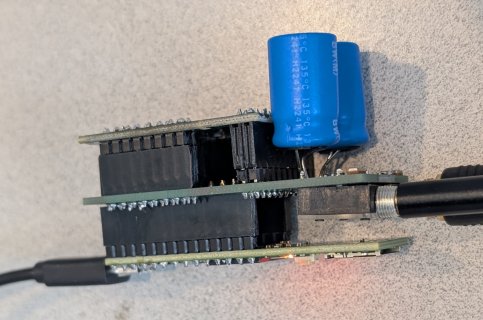

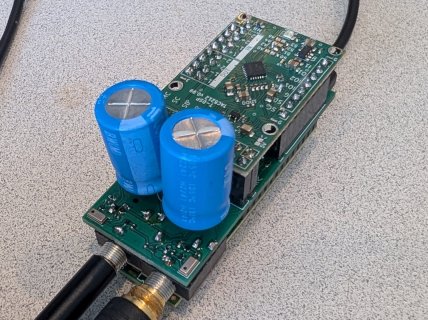

Hey everyone,
I have an update! I ordered a set of 5 prototypes of the audio shield adaptor and TAC5212 modules. Built one, fired up Claude Code and referenced all the drivers we had accumulated. As I imagined, AI augmentation made this process...

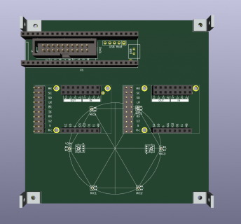

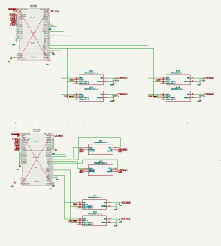

@DD4WH
I mocked up a T-DSP Mic Array Module that should cover your use case.
The design uses two TAC5212 codec modules:
• TAC5212 #1: 4 PDM mics (2 per data line via SELECT pin)
• TAC5212 #2: 2 PDM mics + 2 Knowles SPM0687LR5H-1 analog MEMS...
Yes the TAC5212 does "up to 4 pulse density modulation (PDM) digital microphone interface with a high-performance decimation filter" as specified in the datasheet. I am not aware of a driver for that. Good luck!
