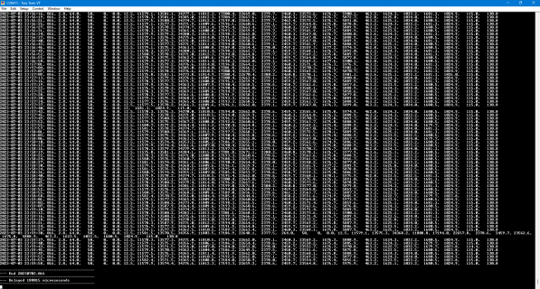

      I have been trying to find a solution using the new insight about USB serial on teensy3. So far, no success. If I check the value of Serial.availableForWrite() and wait for it to be 64, the program hangs until watchdog reset about 80 seconds...

      I have numerous applications that store data in files on the SD card. One feature of the program is to print the file to the USB serial interface. "Because of Windows", and in particular "because of usbser.sys", I have to put code on the Teensy...
