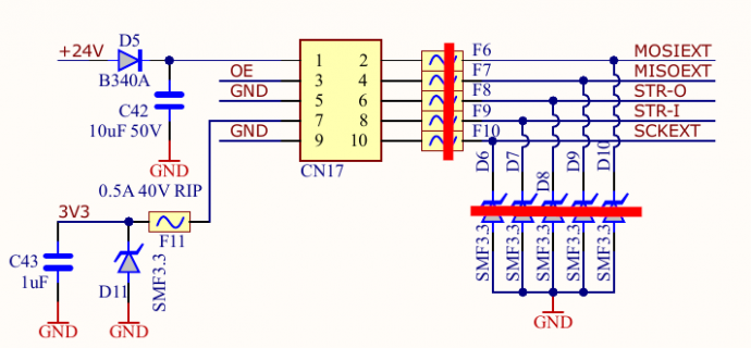

    • J
      JustAUser replied to the thread SPI data via DMA corrupt.
      Ok, So I just trashed the zener diodes and fuses (those are now shorts) that where attached to the connector and tested it again. Somehow it now works without issues. @sicco, Assuming you are on the correct path. Somehow the capacitance of the...

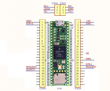

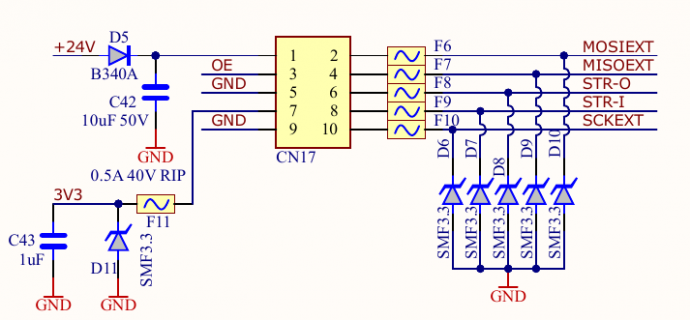

      In post 15 I did share the connector part (that is currently all there is connected to the pins). Today I am going to remove all the protection circuits as well and see if that brings any improvement. Since I didn't make the PCB design myself...

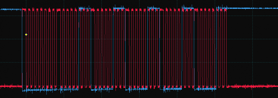

      Well, it keeps on getting stranger and stranger. Today I decided to grab a different scope (Rigol DS1042CD, 40MHz) and to also get the CS1 pin. So what we have: 1 (Yellow): CS1 2 (blue/green): MOSI D0 (red): CLK Note that the overall pattern...

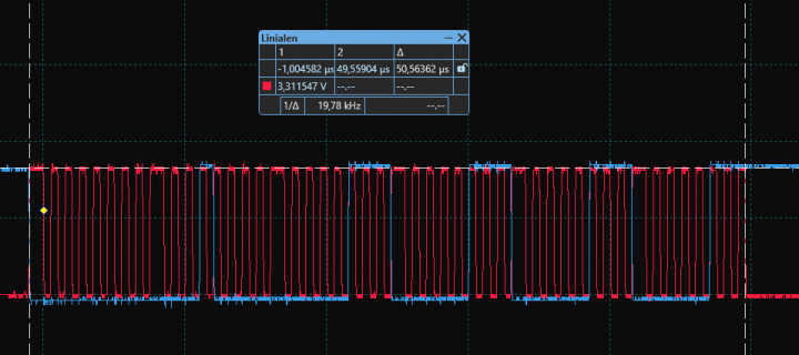

      So, just to check if I'm not crazy I switched back to my old breadboard and the results are interesting. On my PCB version the SPI always outputs 6 bytes with no consistency. On my breadboard it behaves as intended with the same code. Breadboard...

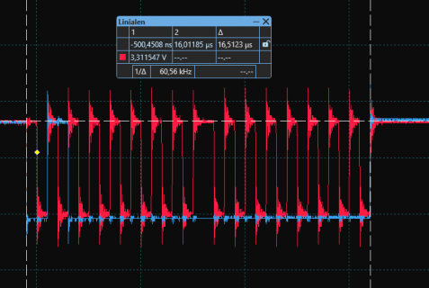

      For my current project I want to send out data via the SPI bus using DMA. In my original tests on a prototyping board everything seemed fine. Now I switched to a PCB and somehow everything started breaking. I attached the full code to the post...
