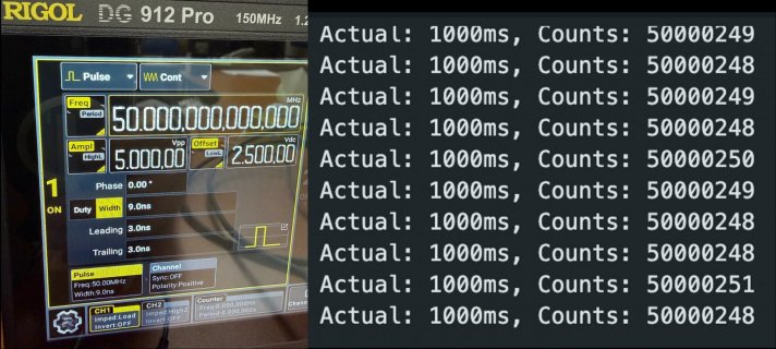

      Hi all ! Further investigation revealed that the 9ns/50Mhz performace with T4.1 was possible with 30ohm/20ohm voltage divider ONLY. I mean 50ohm seen from the Rigol source and 30ohm from the T4.1 pin 9.

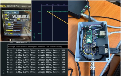

      One additional note: Since the time base accuracy of Rigol 912 Pro itself is specified as ±2 ppm, the measured 5 ppm offset may not be entirely from T4.1. YP

      Hello? It turned out that the pulse counting limit of T4.1 is far better than I originally thought. The figure below shows T4.1 can go as much as the Rigol DG 912 Pro waveform generator will go: 9 ns at 50 Mhz. There is not-so-random counting...

      Hello? I remember there was discussion for using Teensy 4.x as a fast pulse counter some years ago. Pictured below is the pulse counter I built using FreqCount function, and all I need is counting 1 us wide pulses, I kept reducing the pulse...
