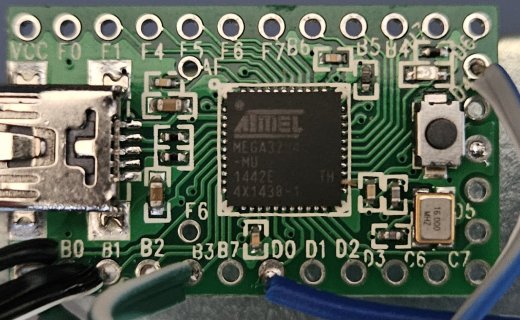

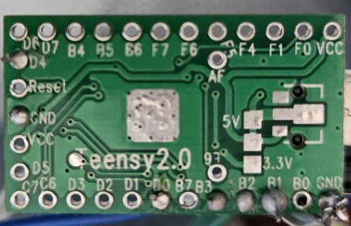

    • L
      Lichtkegel replied to the thread Teensy 2.0 donwload.
    • L
      If I wire GND and RST it the same result as I am press the button: windows gives a signal and Teensy lost the connection to the pc. When I release the conncetion/button teensy is back again.

      Hi, I bought a pinball controller with a teensy 2.0 integrated. It simulates different keyboard keys on pressing the buttons from the Pinball controller. I already loaded the nessesary files an the teensy seems tob e recognized from the arduino...
