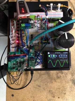

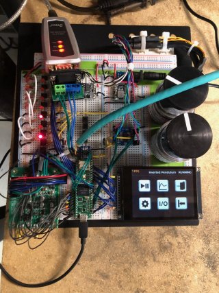

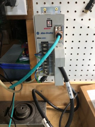

      Since the sticky thread recommended project photos, they are attached here. Teensy 4.1 TI DAC8563 eval. board (+/-10V analog out to servo drive as torque reference) 4 inputs, 4 outputs, optoisolated 24VDC MAX14789 transceiver for RS485 serial...

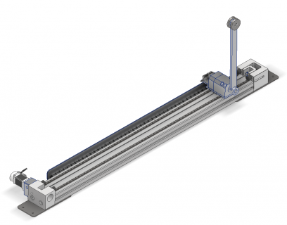

      Hi All, Related to my previous post but more general. I have a large project running on Teensy 4.1 to make a real-time inverted pendulum controller. The teensy is responsible for all tasks, except for torque amplification of the AC servo motor...
