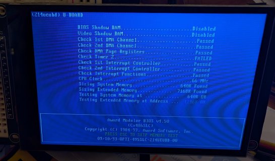

Let me clean a few bits up and put it somewhere. I'll just have it set to output to serial console for now so you don't have to mess with an LCD. You will need 16 MB of PSRAM on your Teensy though.
Wow, this is really great! Do you have any approximate estimate of speed equivalence?

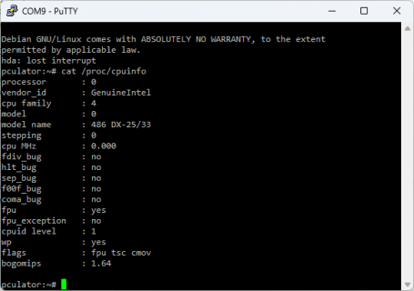

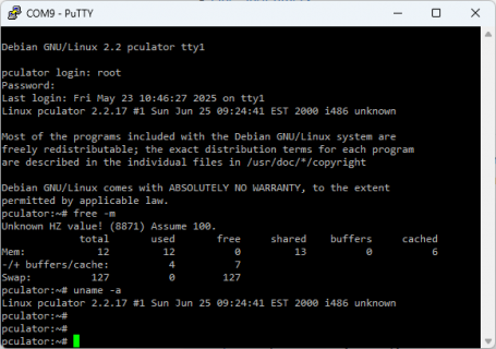

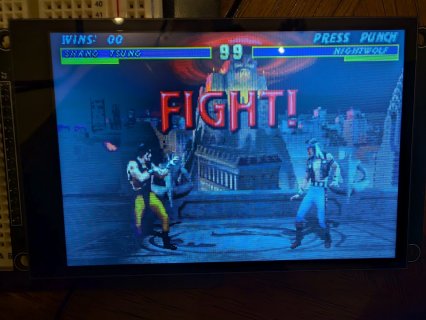

Thanks! I'd say Linux runs like a slow 386 and DOS games run like a mid-tier or fast 386.
The display performance has to be pretty slow, think 5 to 10 FPS. Otherwise the rendering will start eating away at the CPU performance too much since the...

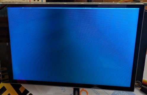

The big-screen-t4 branch mostly works for me with the 4" ST7796! Async update wasn't working in the normal library, which is what I needed. However, it doesn't work if turning on continuous updates. Only one-shot. That's fine for me, but just FYI.
I got this 4" 320x480 ST7796 LCD from Amazon. I'm trying to use it in my project, but whenever I try to use the async display mode to speed things up, the output is complete garbage.
I'm initializing the tft with this:
// For 3.5" or 4.0" TFT...
Thanks! I'm not sure how useful it will be to play 486-era games, but it's a fun experiment to see how far I can push the Teensy. An old Linux distro seems relatively usable on it if you are just doing console mode text stuff. Commands and basic...
