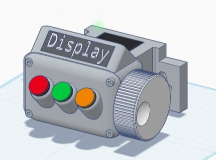

      This is my controller. I could have easily done a touch screen controller, but I like the tactile feel off buttons and knobs. I went 1000ppr because the stepper motor is closed loop with a 1000ppr encoder. It will be driving a 4mm leadscrew so...

      Hi All I am trying to get an RPM tachometer working for my lathe using FreqMeasure.h the RPM range will be 1RPM-2000RPM The encoder is a generic Chinese ( OMRON style ) 1000ppr with A,B & Z. The Z outputs 1 pulse per Rev with 5v output The enc...
    • M
      Problem solved. I used FreqMeasure on pin 22 and QuadEnc on pins 31 & 33 and just shared pin 22 and 31 from the Quad encoder. works flawless up to 2000rpm and now I get enc posn and RPM and as they use the hardware encoders it lets the program...
    • M
      1000PPR and max RPM would be 2,000RPM at most Quad Enc 1000PPR was selected as it ties in with leadscrew closed- loop stepper encoder
    • M
      I did find Quadencoder, but it was after I had the PCB made, so it is going to make it very hard to use. grrrr Direction is not a factor for the RPM, but essential for the leadscrew sync I am not using the SPI bus at this stage so I might be...
    • M
      I am wanting to get an RPM value from a quadrature encoder that is used to control a stepper motor driving a lead screw on my lathe Full project https://github.com/MorryStu/Lathe-controller Unfortunately I am tight for spare pins on the...
