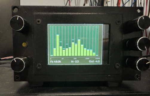

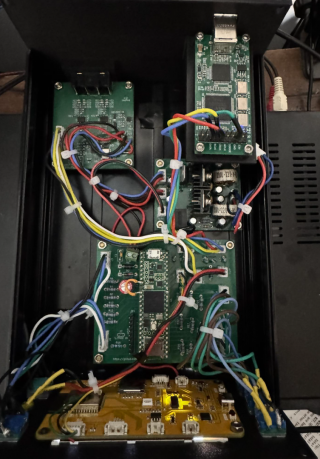

Here's an audio equalizer and general purpose DSP platform I put together. It's made up of an Teensy 4.1 for the DSP, a CYD (Cheap Yellow Display) for the visual part of the UI and a ES9039Q2M board I...
I'm curious where you ended up with this. I've written a very slimmed down floating point-based audio pipeline supporting multiple sampling rates. I modified the stock I2S inputs and outputs and it works like charm at least up to 192kHz and...
