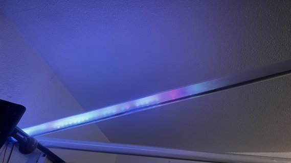

10 Leds? Your strip looks longer
btw the color order just changes the order ... even with the wrong order you would get the...

Hello,
For starters, I'm quite the newb. I have gotten an Arduino Uno R3 to run TouchDesigner on my 6 strips (after 6feet of 3-pin cable run) up to 40 pixels across all strips. But when I tried to bump it across the whole strip (140 pixels), I...
END GOAL:
Replace the Arduino Uno R3 in my LED setup with the Teensy 4.1 to extend my working 40pixels per strip (6 strips total) to be able to handle 140 pixels per strip.
THE LAST BEST STATE:
I was able to send GRB values from Touchdesigner...
