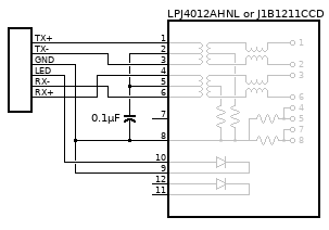

    You absolutely do need the 0.1uF capacitor. That capacitor inside the magjack is for a different purpose. If you look at the datasheets for the Cetus and LinkPP magjacks (again, scroll down to "Technical Details" on the ethernet kit page)...
  • PaulStoffregen
    Probably is likely due to RCT and TCT shorted to GND. Cut this wire and add a 0.1uF capacitor. Here is the schematic from the ethernet kit (scroll down to "Technical Details") for comparison.
